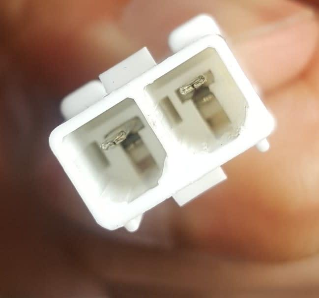

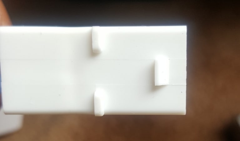

I have a two pin and three pin connectors.
How do I remove the pins for these one? Normally there's a locking tab on the bottom. For these I'm not sure.
If you don't have a AMP connector flat pin extractor that is the easiest way to do it. You can push the latch pins in so much that you then have to pull them out a tad to relatch them.paceman said
insert a small screwdriver and depress the locking tab - those small jewelers screwdrivers are ideal. Helps to pull gently on the wire at the same time.
You insert the Screw driver in from the front of the connector to "pick or depress the latch" then gently tug the wires from the rear and it should come out the back.
Thanks Brian where are the latch pins? I'm struggling to find that
