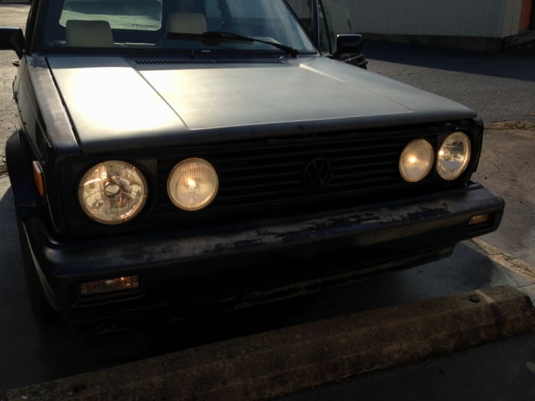

I am working on making a wiring harness as per the http://www.cabby-info.com/Files/RelayingTheHeadlights.pdf link suggests.
I have low 2 beam and 2 high beam lights in the grill. I am going to make adaptations to the harness to make the set of high beams work.
My question is this. My car has some Halo around the low beam lights and the indicator also illuminates, There is a wiring tee that goes to the low beam and indicator lights in the bumper. My question is, will this stop working when I install the new harness as per link? What would I need to do to make them work , if so?
(I think I had the high beams on in this picture, so I don't think the high beams in the grille come on normally)
If they "t-ed" the halo lights on the low beams that is one thing, if they have them as DRL (daytime running lights) that is different.

Well to have the halo's on whilst driving, the simplest thing to do is to turn on the DRL position of your light switch (1click)
I don't have side markers per se, or rather no bulbs or lights in my side markers on the fenders. I was talking about the lights in the front bumper in my post. Those lights come on with the DRL.
