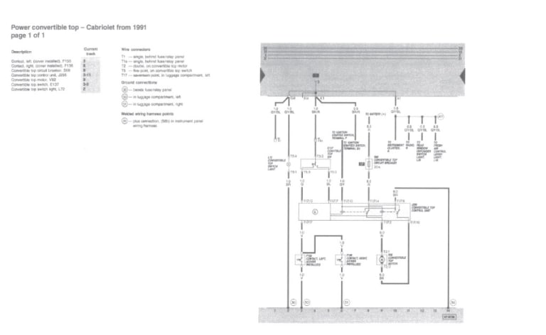

My hood works with the engine running. I know it shouldn't, but I curious as to how it should be wired.
There is the main power with the thermal fuse, then there is another red, and a black. The black doesn't seem to do anything.
2)
I've done that's stoped the hand brake light and interior light from working. Are they both negative switched? Any ideas, what would kill both.
Whip

My understanding of the hood is that it is powered on by the SU circuit (key in ignition but not turned), but doesn't work when the engine is running.
There are a few circuits I don't quite understand…
The handbrake light is negative switched, right?
The battery light on the instrument cluster goes out when the engine is running so there must be a way it knows. Power from the alternator perhaps.
The black wire from the hood comes with a splitter suggesting it goes to where something else is already connected. It's not needed to power the hood, so perhaps it disables the hood when triggered?

https://vwgolfmk1.org.uk/forum/index.php?page=topicview&id=electrics_2%2Fwiring-electric-roof

Looking at the wiring diagram for the hood, One wire is from SU, and the other from switched power(P). My guess is that SU powers on the hood and switched power disables it. I'll have to test this.
I generally only open it with the engine running as it draws a fair amount of power. The handbrake switching would have been nice.
