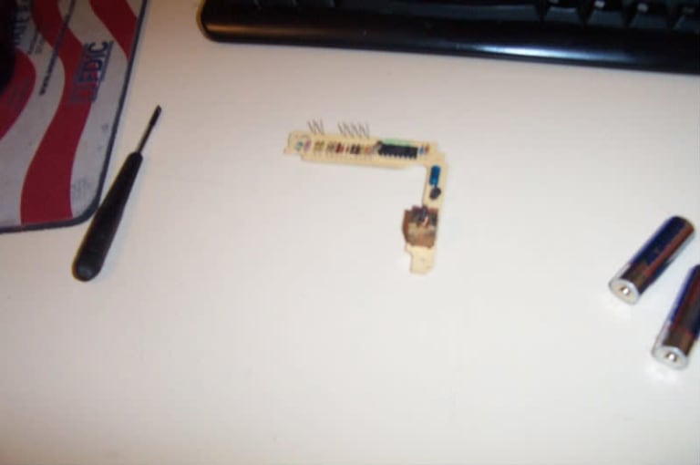

Here is the light and Buzzer pcb mounted inside the Speedo.
It is in the back of the speedo housing, that is you have to remove the cluster to replace it.
Why they put it there IDon'tKNOW.

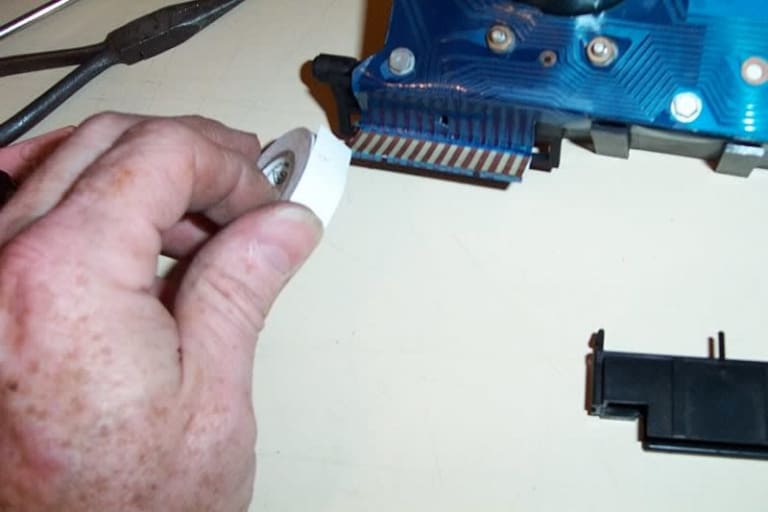

You can remove the Mylar connections shroud, carefully remove the mylar off the tongue of the housing, then place a single strip of electrical tape on the pad side of the tongue. Replace the mylar, and the shroud. This will tighten up the connections.
