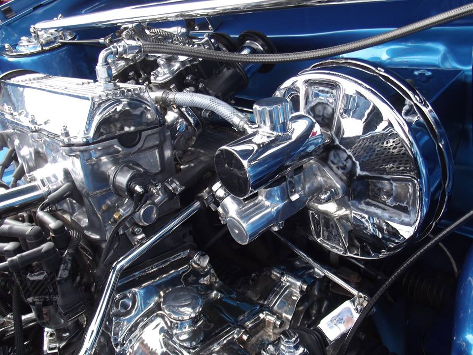

Ok this is the position of my oil pressure sender on the head,this was ok when I had a 1900 bottom end but since rebuilding the engine with a 2.0 block the oil pressure is now lower,I believe this is because of the oil ports on the 2.0 block are different therefore not giving a true reading of the oil pressure ? Am I right in thinking I could remove the sender from the head and place it in one of the ports I have on the oil filter housing and then blank the head port ?

All I can say is SHINY ENGINE, where's my sun glasses.
