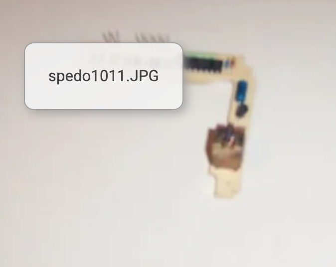

The light is controlled by the "EL" shaped board in the back of the speedo housing, they do go bad occasionally.

The White one 1.8ar should be grounded when running and only open when the pressure drops below 1.8 bar @ 2000 rpm. Causing the oil light flash and Buzzer to squeal.  The Main control for these as stated is at the rear of the speedometer

Okay, so the 1.8 bar (blue wire in my pic) is supposed to be grounded when the engine is running.
Grounding that wire causes the light to flash when the engine is running and also when it isn't running.
That suggests that the cluster is at fault and the engine is okay - right?
I still have the mark one clocks to test this with. Can I test with just positive, negative, and 1.8bar wire?
