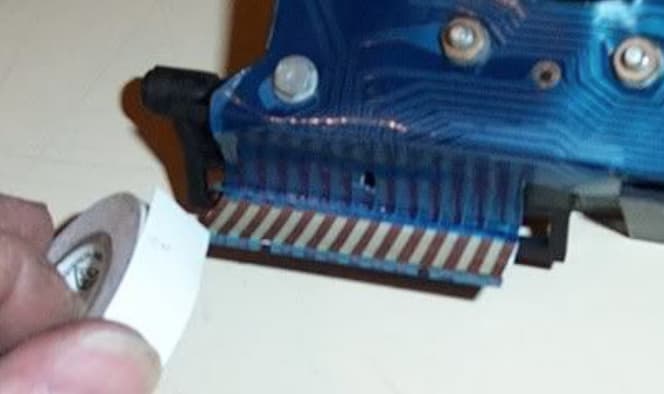

If you haven't "Plumped" your main connector by placing a single strip of electrical tape on the plastic tongue of the clusters main connector under the Mylar it wouldn't be a bad time to do that and add a new ground to the cluster….

When you talk of taping the pad side of the plastic tongue, which side - it might be obvious, but without it in front of me I'm struggling to visualise

When you talk of taping the pad side of the plastic tongue, which side - it might be obvious, but without it in front of me I'm struggling to visualise![]()
He left a link to a how-to at the bottom of his post. You can see the white tape through the mylar here:
It's on the other side to the face you can see so that it pushes the contacts tighter against the connector.

Ah yes, hadn't quite zoomed the pic .. must help isolate the strips better.the_whip said
Cheers for that

Added the extra earth behind the cluster, and the tape etc - No change on the 4k rpm alarm, with individual sender
