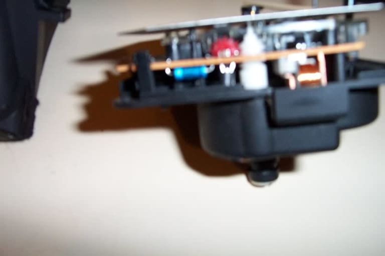

How to resolve:
Remove the Bezel, and switches to facilitate the removal of the clocks.
Carefully disassemble the Mylar off the clocks and remove the front from the rear assembly.
Remove the speedo from the cluster assembly.
Look at the Red Gear usually on the VDO cluster (name on the face plate).
If the Gear isn't missing any teeth, then you can carefully move the gear and clean the shaft.
Apply a small drop of super glue to affix the gear back to the shaft.
