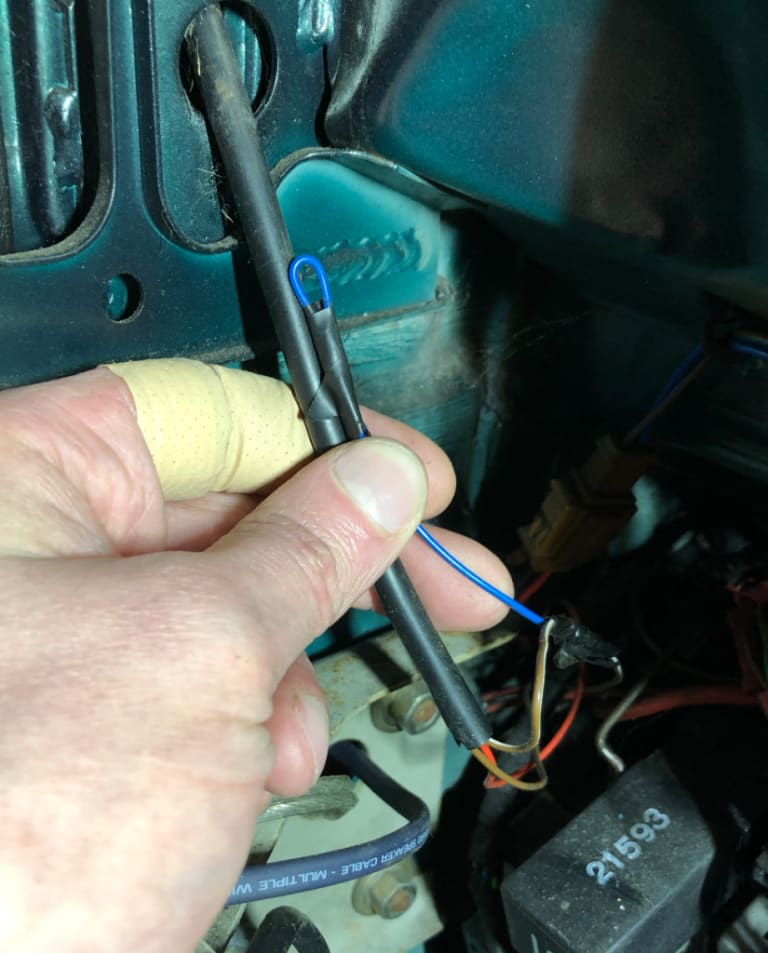

Any idea what this is (blue and brown wires into the brown plug)? it says:ат€Siemens155 035 439 and ends up near the stereo (not connected to anything).

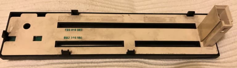

Is this dash light supposed to be soldiered to wires?
It connects to this switch plug

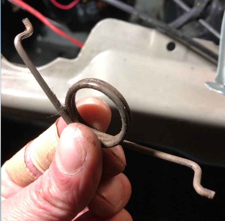

Should these connect at the same time or does should you be able to use the wiper then pull further for the squirty?

The smaller white connector looks like the defroster connector, if there is a black/yellow wire on it then that is the Defroster. Connecting a wire to the black/yellow is the one folks usually tap for a Switched Power to the Stereo.
Solder/heat shrink is the better way to splice in to wires as the crimp AMP connectors are ok, but they fail….A good solder joint never does, and wires can't be pulled apart.
There are plenty of threads on the heater controls and how to repair the bulb. I have done it, and well I sawed it flat off the back, and remove the bulb, then using small drills and Dremel trimmed what I needed to replace it with a Super Bright led, that I soldered to the connector wires, then used JB-Weld to affix it. I also found that the Super Bright LED was so bright that I had to wrap the body of the lamp holder to keep the white light stay in to the plastic.
There are better how-tos on the interweb.
here is the one where I saw it off.
Just picked up a cabby, have some lighting questions. | VW Vortex - Volkswagen Forum
The one I really liked and duplicated.
https://forums.vwvortex.com/showthread.php?7081949-88-Cabby-Heater-Control-With-Non-Removable-Bulb-Mod&highlight=replacing+heater+control+light
The wiper stalk is an easier fix, as just replace it.
The contacts can get burned or mal-adjusted and the washer doesn't work.
Here is my tried and true quick fix for re-aligning them on the stalks.

The bulb should have a Ground on one side that is Brown, and a blue/gray or is it gray/blue….? I don't know where it is coming from.
The blue wire that is tucked in to heat shrink is a good way to terminate a cut wire and to insulate it from shorting out if it is carrying a live wire.

I'm still somewhat confused as to why my instrument bulb has wires connected to it when no-one else's does
