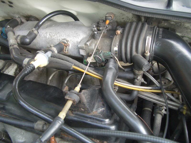

looks liek it goes to the aux air valve, wee box attached to the turret on driver side with some vac pipework to it. if you dont have one then dont worry about it, this was only on later kjet cars. if it is for this valve then you will have a relay above the fusebox that makes it work
Fuse box is a bit of a mess and I try to avoid looking at it at the moment! I have the aux air valve behind the inlet manifold which has a connection…

I'm guessing that it doesn't need the additional air thingy then? and that these 2 connections are probably connected to said air thingy and can just be blocked off?
Throttle switch - it doesn't have one. Which I think is ok..?! It's a DX k-jet btw.
And I had a spare small bore vacuum line coming off the brake servo side of the inlet manifold which I wondered what to do with, so I guess I've found a home for it now!

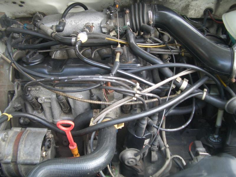

you can see in this picture the air pipe which fits to the back of the head between cyinders 3 and 4, it's for the fuel injectors to add air to them, air shroud injectors.
MOTY 2013
the nipple on the head is for the later air shrouded injectors, if you got nothing to go into it you can just cap it off as it doesnt really do a great deal.
