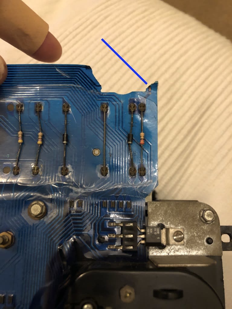

Going back to the board. I have tear which explains the lights not working, but there is also another break…
This seems to go to ground in one direction, and into something (is it the voltage regulator?).
Could this explain the MFA not working?
