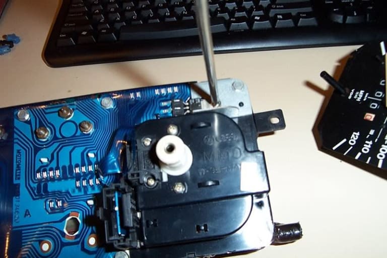

rear of VDO
side of VDO
Red Odo drive gear.
rear of Motometer
That little white sticker is what I am talking about.
fronts of Moto, and VDO

rear of VDO
side of VDO
Red Odo drive gear.
rear of Motometer
