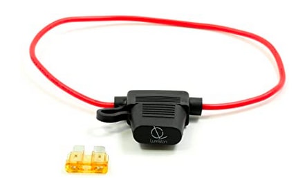

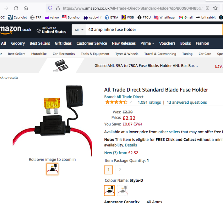

Trying to find a 40 amp inline fuse holder and the only ones I can find are 20 or 30 amp rated
Found this on EBAY UK.
I use these guys for all things electrical https://www.vehiclewiringproducts.co.uk/
I needed a 40amp in line fuse for my headlamp relay upgrade, I couldn't find 40 amp blade fuses so went with one of these https://www.vehiclewiringproducts.co.uk/c-52-fuse-boxes-fuses/c-124-midi-mega-strip-fuse-holders/p-355-strip-midi-fuse-holder
And bought the relevant fuse. You need 5mm ring terminals to connect to the fuse holder (double check that though!). Just make sure you buy cable that is rated higher than the fuse you will be using, and make sure the ring terminals are the right size for the wire.
