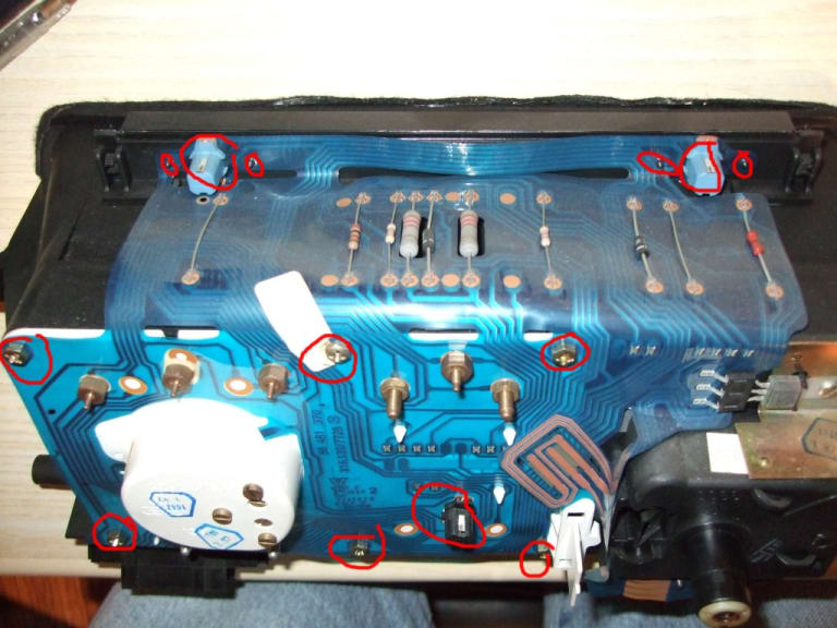

1st remove cluster from car, on a MK1 this involves removing half of the interior first…
to dismantle the cluster I removed the 8 screws (two not shown in pic to far right) and the lights that hold the blue circuit board down, highlighted in red….

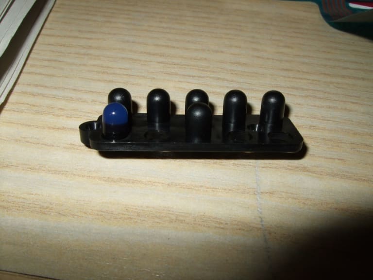

this then allowed me to gently lift out the 3 main components (rev counter, LEDs/fuel gauge and speedo) as one held together with the blue circuit film from the cluster housing. Then when turned over I removed the black plastic LED 'shield' to reveal my problem. As suspected when built there were no blue LEDs so VW used a clear LED?/filament bulb that had blown and a blue plastic mask;
Back in 2006 I went off to Maplins to get a blue LED, unfortunatly they only had chav type bright blue LEDs, I got a clear one and this other shown with the orginal blown white LED stylee filament bulb. They were 3mm so could be used under the blue plastic mask so not a big problem. These days use Google/ebay to get a blue LED? Insert the right way, short leg or flat side = -ve connection;

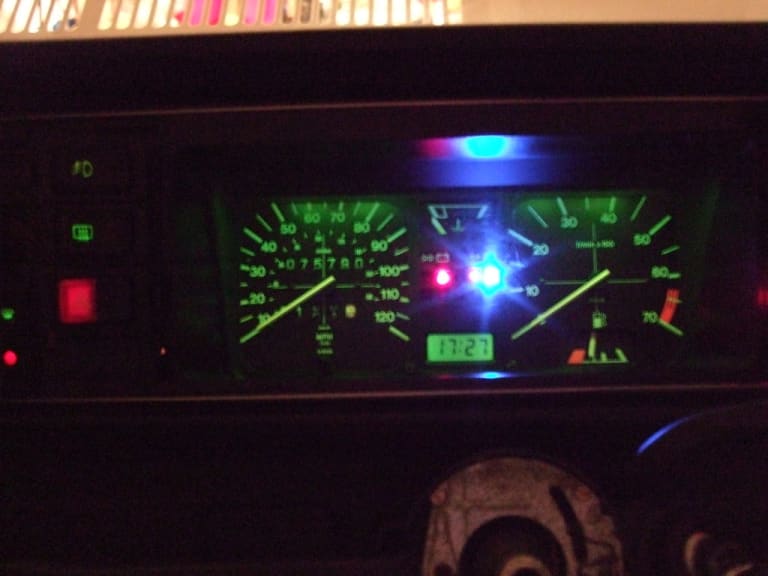

Put everything back togther and test. Is brighter than the other LEDs but not as bright as camera makes out;
If I was to do it again I would have used a lower 1.5cd output LED, instead of the brighter3.2 cd type that I did use.
