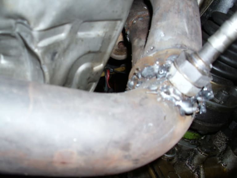

But I placed both of mine on the right side of the car about half way up the right most down pipe, very easy to get to.
here is my mock up the welds got prettier when I had ot off the car.
Yep that is a old license plate being used as a Heat shield for the power steering rack.
