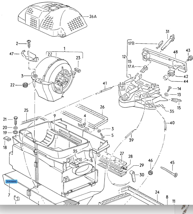

Hi guys my heater motor keeps blowing fuses and is seized up. Do I get it out from under the bonnet or is it the whole heater box out which I don’t fancy doing. Looks like under the scuttle panel there might be access to it.
VW's heating/aircon workshop manual is very sparse, but the diagram suggests the motor is accessible from above, secured with "fillister head tapping screw with washer"
a/c or non a/c?
No aircon
Good, the diagram I mentioned above relates to non-aircon system
