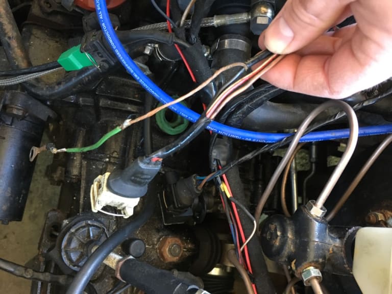

I was tidying up the ecu earth to the rocker cover and found this lovely repair but also that this was connected to the rocker cover as well does it need to be? I'm guessing it's a shield/screening for the lambda but is the rocker cover the best place to re attach it?
MOTY 2013
I assume it would be earthe3d to the lambda support bracket on the rear engine mount bracket same as it is on the normal G60 engines. any decent earth point will do you fine
