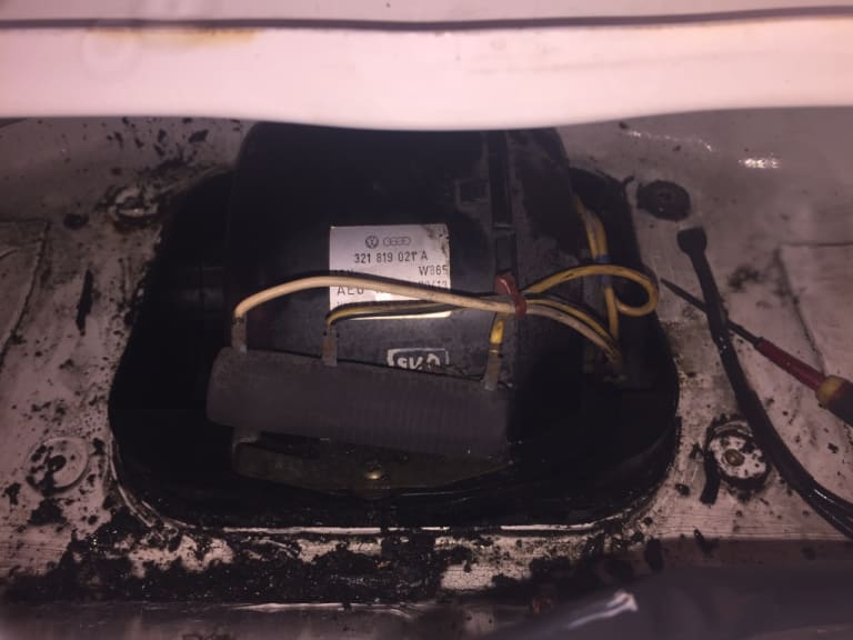

Hi pal i have a couple of questions been searching the forum for the past few hours, where are the resisters of the heater located? have you a link to the blower replacement guide thanks pal
Older models had a resistor pack on the side of the airbox that once removed looked like a bunch of wire springs and not a resistor per-say.
Later models had either a replacement resistor attached to the Motor, or on the Cabbies with air a resistor that was welded to the motor.
Briano1234 said
A/C or non-ac and year specific.

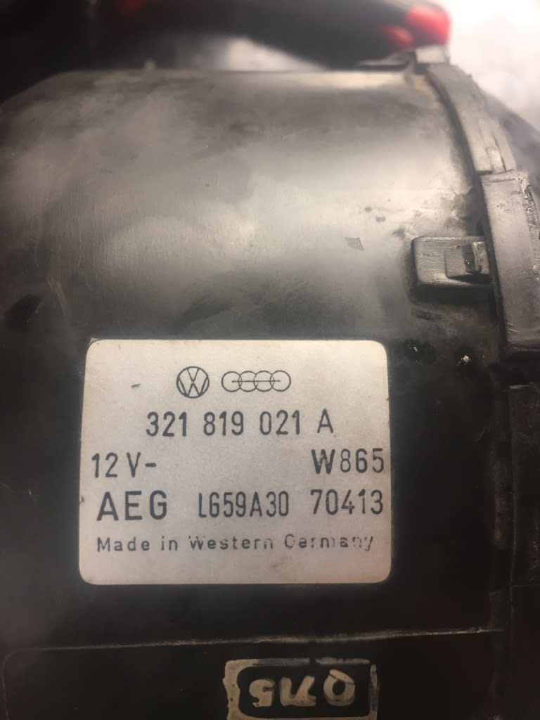

Excellent all done with the help from you guys.
I can confirm the motor is well and truly seized ' know to find a replacment, would you think the resister pack would be ok ?
