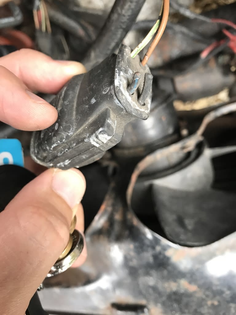

wondering if anyone can shine some light onto why the below two connectors are on the car and what they are for. neither are connected to anything obvious and the car runs happily…?
This one fed by the green wire is on the throttle body/inle manifoldt, just above the breather pipes
The second is down in the free space above the gearbox and is just resting on top. Some wires aren't even connected?
The car does have 3 VDO gauges on the centre console however none of them work (all the sensors are VAG sensors and drive the original instrument cluster gauges)

2nd is the early MFA reverse switch, for the cluster with the MPG needle and shift light. again if its had a later box put in they only have a 2 pin reverse switch, which is what the 2 cut wires on the plug are for.
VAG Documents & Downloads
It is a DX engine but not the original so may be an early mk2 8v engine as you say.
The reverse switch on the gearbox is only two wires, so same again there!
