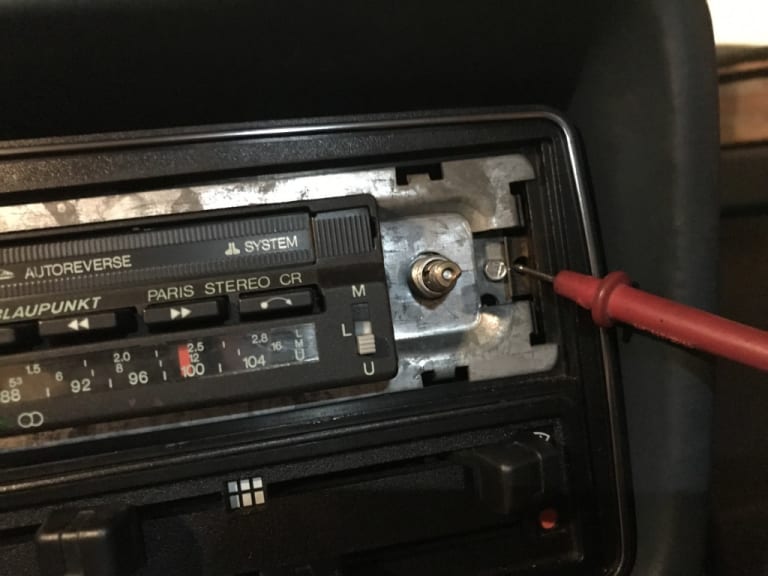

carefully pull off the two selector knobs and the underlaying levers and note which side is which. take great care to notice the dual and triple function of these levers when refitting them.
once they're off screw off the two black washers, they aren't washers they're actually threaded and holds the whole radio in place… I was able to screw them off by hand.
when they're removed you can take away the plastic trim piece plate and then it will look a bit like this
solid bracket there holding it in place..
now take a flathead screwdriver to the holes in the sides and carefully prise them inwards to be able to take the bracket out from the front.
with the bracket removed the bare radio can be pulled out

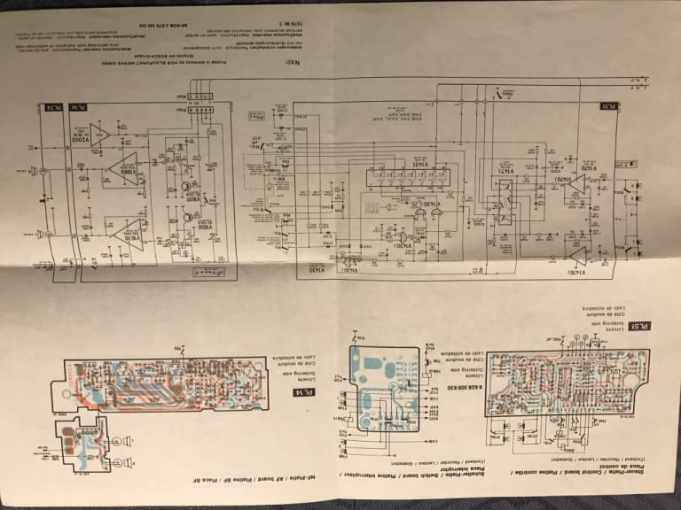

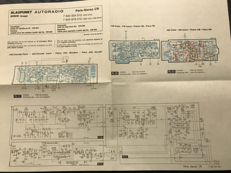

here the full diagrams for the thing, next step is to add a 3,5mm jack but I haven't found a way for this for this model yet, if anyones done it I'll be happy to know how you did! been searching around on pages like https://www.youngtimerradio-shop.de/ but there doesn't seem to be a simple solution
