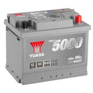

Just wondering if I can squeeze a slightly taller one in there.
*edit*
027 is the size, I believe.

I placed a thin (20mm ) Haynes manual on top of the battery, and was able to close the bonnet.
I then tried with the mk1 manual (30mm), and still no problem.
Next I tried them both together (50mm). I could feel contact, but was still able to close the bonnet okay.
Considering the 027 is only 15mm taller than the 075, this shouldn't be a problem.

I've just brought a 075 Yuasa battery after my last 2 Bosch batteries have only just lasted longer than the 4 year guarantee which they came with, the Yuasa battery which was on the old Honda Civic we had lasted the 10 years we owned the car so fingers crossed for the one on the Golf.
mark1gls said
Why do you want a taller battery?
Extra CCA for the cold morning starts. Though now you mention it, the 075 Yuasa has the same CCA as the 027.
From what I have read I would rather go with a Yuasa. The Bosch are made by, and exactly the same as Varta. Only the guarantees differ.

Agree so unless you are trying to start a Diesel engine in sub 30 degrees frost look at the Amp/Hr. A 80Ah+ will be better than a standard spec 45Ah. Think of it as a bath tub, the starting, radio, alarm etc emptying it and the alternator refilling it. The 45Ah will get emptied before it gets chance to be refilled,
My engine is 2L and kind of running in, so it needs a little motivation when it's hot or cold. I've got a diesel starter which I'll pop in at the weekend. Only things that are powered with the ignition off are CL and clock, so not much drain there.
My current battery (075) dies pretty quickly when starting in the cold, so more capacity is desired.
Yuasa are pretty much sold out everywhere at the moment. They only have the 069 which is 4Kg heaver than the 075.
So:
075
Standard
027
Tall
010
Wide
069
Wide and tall
I think the 010 would be good as it's only 2Kg heavier than standard, and almost as powerful as the 069.
