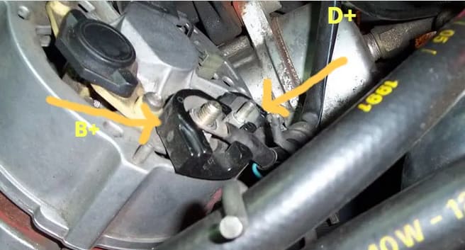

Nice, thanks - to confirm is the alternators positive terminal the d+ terminal or one of the other two?
The large stud is the Positive B+ wire from the battery.
