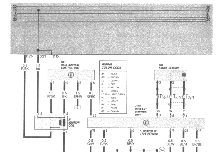

It is unfortunate I didn't get any responses. So I will share my current progress and maybe you can guide me because I am not good with electrical diagrams.
All the continuity of the 4-pin connector to the tach meter is fine. They go to 12v(pin 14), ground (pin 2), red/black cable (pin 5) comming from the engine bay, and the fourth pin is also well attached.
The question is: Signal to the RED/BLACK cable comes from Digifant ecu or from the igmition coil? On Haynes manual is on diagram 97-9190, the G5 index.
The tach has 3 inputs, one 12VB+ one earth, and the signal is red / black which is from the ignition coil, it also feeds the fuel pump relay on sircuit path 1, so I suspect that you have burned out your tach.
thanks for the reply. Is there a way to test it out of the car? I will take it apart and try to debug, but how do i test? what should I feed to imitate the red/black input?
You would need a sign-wave or chopped wave signal generator I would imagine as it is the pulsing wave of the various cylinders firing of the coil that produces the signal.
