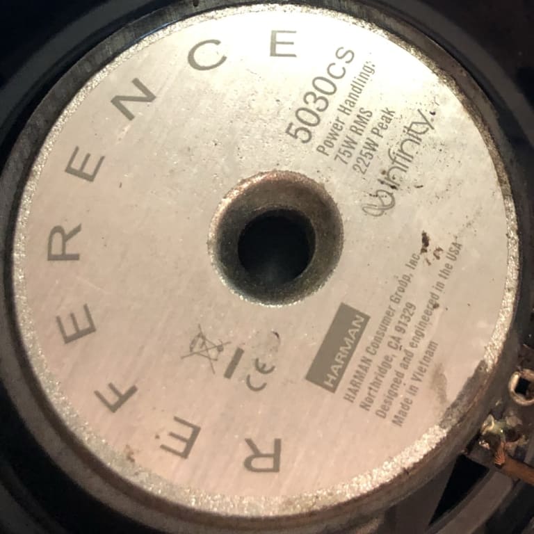

Are these the original speakers?
If the LH and HF units both have their own cables, where are the crossovers?
