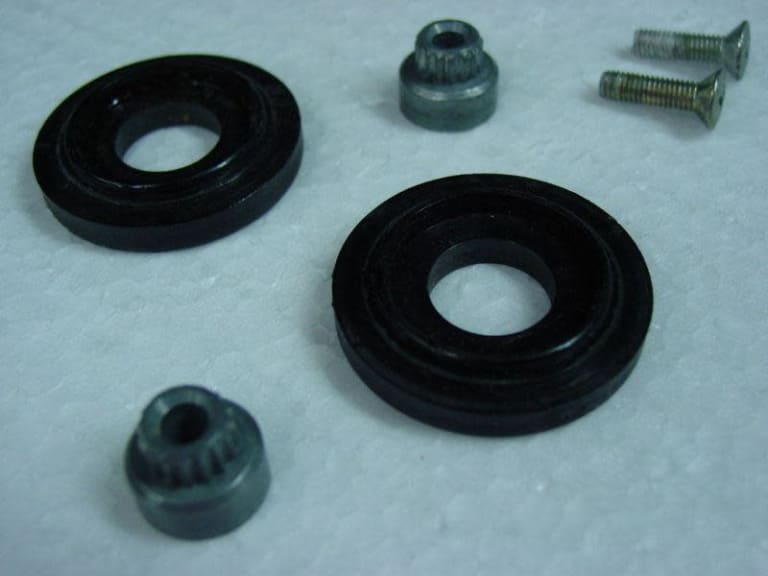

VW have weird window winder trims, the centre doesn't pop out to access the retaining screw, the whole plastic cover has to be prised up and slid out of the way. Mad, but I found the explanation in a Porters manual.
Depends on which type you had, I forgot to mention it…The Chrome handles on my Diesel Bunny was a bit different…But you are right.
