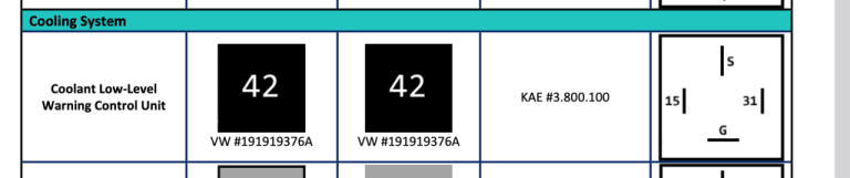

well on my 90's cabbies, the relay is numbered 42 not 43, I didn't ever see a 43 labeled relay…  But the relay is located at position 1 in the ancillary row on top of the fuse panel
Screen Shot 2025-07-31 at 7.12.06 PM.png Screen Shot 2025-07-31 at 7.12.30 PM.png
