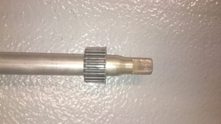

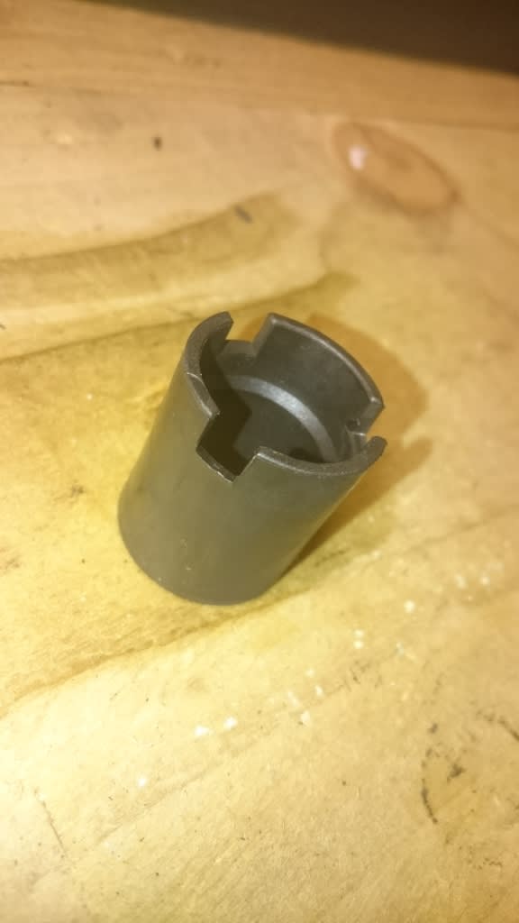

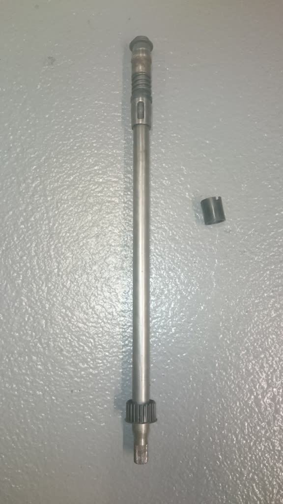

ive got 171419517b bearing down the very bottom
171419341 plastic surport up the top that runs inside the ignition switch bearing
i have a new 171419549 where should that be fitted or is it not used with my type of column ?
have attached a few pics showing where the bits were to.
should there be any spring down the bottom ?

you should have a spring at the bottom, 481419343B assuming its a RHD. this fits between column and steering universal joint
