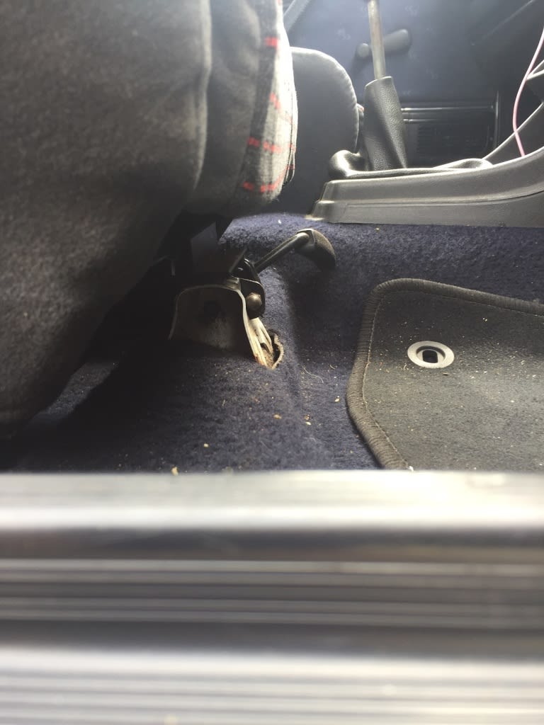

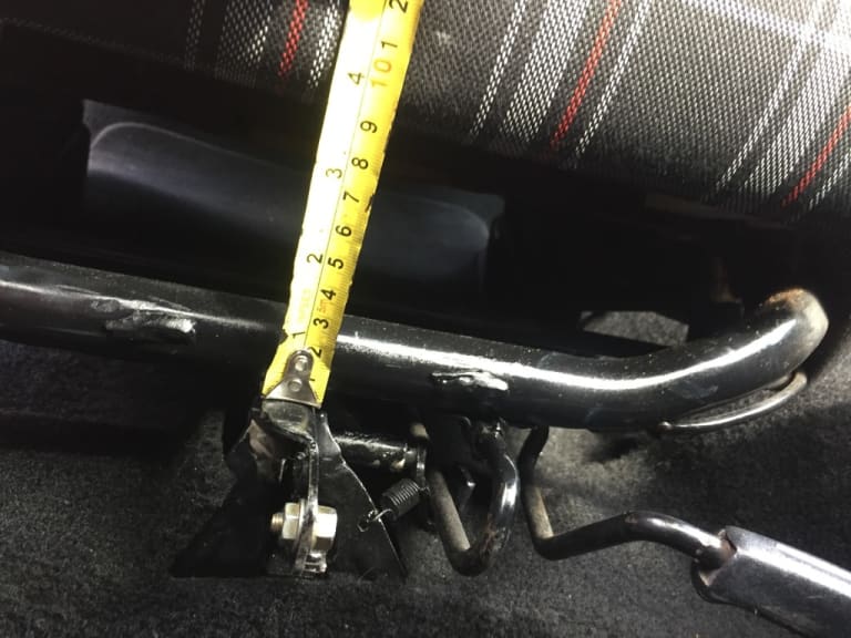

today was working on another mk2 golf with recaros and took some pic/ measurements for comparism
so 5cm lower & level!

just fyi the mk2 recaros you measured dont have factory bases, so too high.
the proper recaro supplied bases look pretty much the same as what you have made, basically a bit of box section with some holes on the top. Main thing they have over yours is the part the seats bolt to is seperate from the main base, it has 3 bolt holes in the front and back which allows you to adjust the height of the seat if a bit time consuming and awkward
http://www.mercadoracing.org/10/493103/bases-de-asiento-recaro-para-golf.html
the factory fitted recaro seats have electric height adjust bases, very posh. scirocco and corrado are similar but even lower
FS: 2 Power Recaro Seat Bases | VW Vortex - Volkswagen Forum
also worth noting your seats are ford escort fitment which have an extra frame welded on the bottom, to convert them to be like standard flat base type recaro seats same as VW you can chop that bit off and weld nuts or fit rivnuts into the 6 empty holes:
