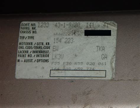

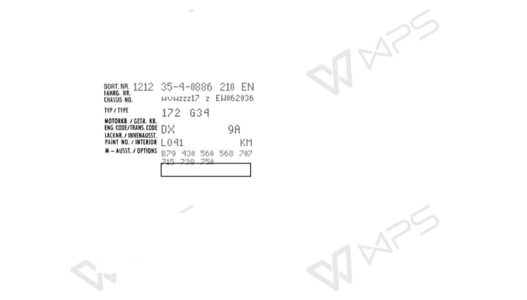

heres one I made up
an original one
sporttrucker said
heres one I made up
What font did you use to produce this perfect copy?
