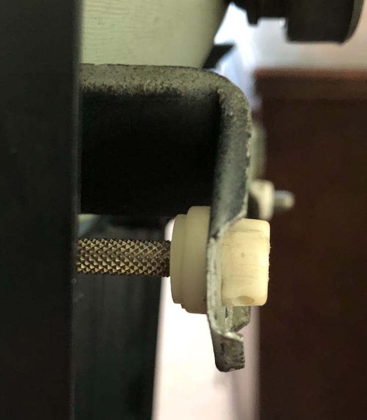

Basically you are going to use a socket on the back side start with a shortie.
Then with a pair of channel-locks or a C-
clamp you are going to press the top into the bottom. That is you place the socket (big enough to fit over the nylon keeper but not too big.)
then press the top to the socket.
