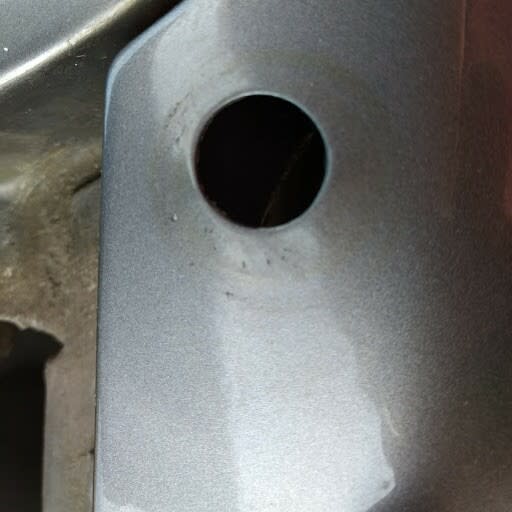

Front wing aerial hole shape
#1609995
(In Topic #219780)
1 weld in new metal, and create new hole if fitting an aerial.
2 if fitting an aerial, clean underneath, glue treated larger metal plate with new hole to underside wing, metal fill top of wing hole. Clear hole, make good and paint as required. Fit aerial. Remember to earth aerial with additional wiring to another part of inner wing.
Hopefully limited amount of original hole will be seen under aerial gasket.
Hope this helps.
