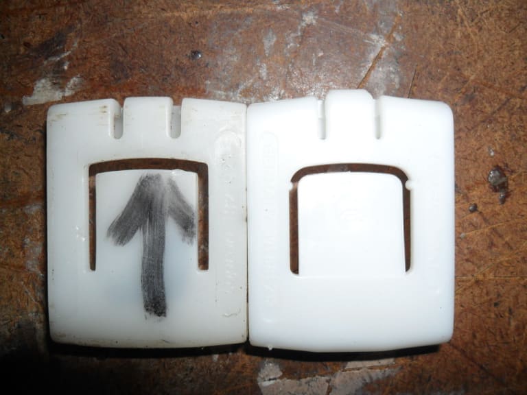

Measured them against the pattern part …. and……. 1.5MM difference in height compared to a new Topran copy part! Also the "tab" sticking out of the top was noticeably longer on OEM.
Not easy to see but in the pic below the Topran is on the left - OEM on the right.
Fitted the seats - NO ROCKING!!!!!!!!!!!!!!!!!
Very happy days!

Well top marks go to Briano1234………..
I ordered a pair of replacement inner seat runner guides. I was surprised when they arrived to find they were OEM VW items.
Very happy days!
https://www.justkampers.com/191-881-213-golf-mk1-mk2-jetta-mk1-mk2-1979-on-scirocco-inner-seat-runner-guide.html
This was the item I bought. When delivered they were VW originals. Certainly did the job to my amazement!
