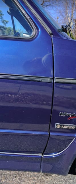

I need to adjust my bottom hing back about 1.5mm so as to lift the door slightly at the rear but I cannot find any means of doing this short of cutting off the hinge and re-welding it. There has to be an easier way?
Is the front wing the genuine wing or an aftermarket one?

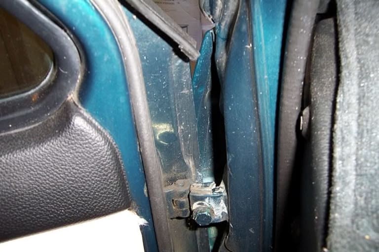

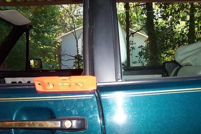

Sagging doors and Cabriolets are hand in hand. Folks allow their full body weight to the door to get in and out of the car. Usually it is the Drivers side that is sagging.
Now knowing the way it is sagging determines how to fix.
Validate which part is sagging, that is sagging at the back end down?
Or Back side up?
To correct the sag as I stated you have to usually bend the hinges back as they have moved about.
Steck E-Z Store Door Alignment Tool - 21845, Tools: Auto Body Toolmart
Remove the door off the hinges and realign the attachment point to be parallel to each other and the same center line vertically.

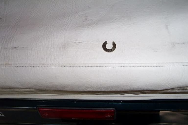

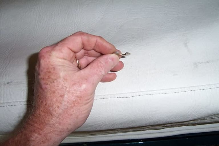

or you can try shimming them using a cut washer.
If your door is sagging at the back end, then you will insert the shim between the top two parts of the upper hinge as that will kick the door up at the bottom.
Loosen the upper bolt
Pry the joint apart, and using a Hemostat insert the cut shim inbetween the hinges and over the bolt, then tighten it.

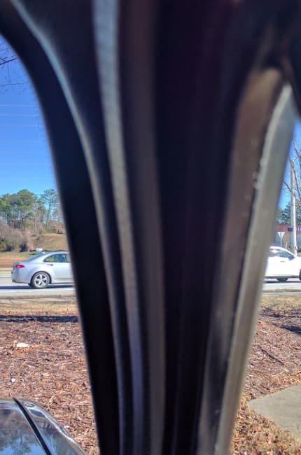

You have to make sure that your in and out of the hinge halves hasn't moved, and that your other adjustment align as in the upper vent wing seal gap.
And that your window fully engages the upper seal correctly.
Other wise you are looking at multiple adjustments as in window tracking and re-positioning the door.
