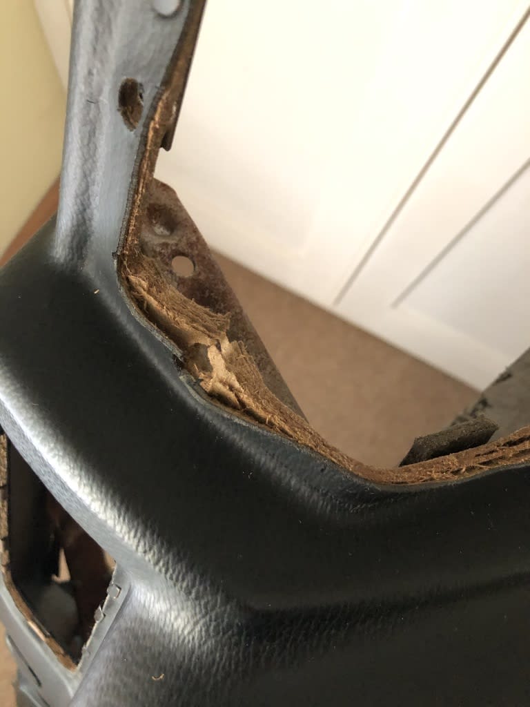

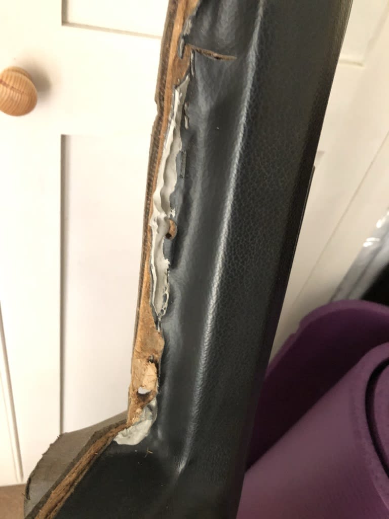

Any thoughts on how to tidy this up a bit? Looks like someone has already tried. I'm not sure what sort of glue would work.

Well you have to repair the substrate that is re-affixing the fibre (cardboard layers) with compression and glue. Once that is back and firm (epoxies and or water proof wood glue) then you can try to reattach the vinyl with glues, be warned that you have to gently warm the vinyl so it can re-stretch more easily with out breaking or tearing as it has to be softened. I have found that WD-40 that is allowed to soak both sides, and or Brake Cleaner helps to soften the vinyl and allows it to stretch, the WD-40 has to be removed from it with Brake cleaner prior to trying to reattach with adhesive, (water proof contact cement) " Amazing Goop Plumbers Glue" is good
After you get the substrate reglued (spring clamps and wood paint stirrers work well, bit remember to Wrap the sticks with Wax Paper to prevent them from gluing to the repair. I then apply 2-3 coats of Exterior Polyurethane varnish to the fibreboard to prevent water or moisture from further attacking the dash.
Okay, I'll give that a try.

To add to my previous post I have used popsicle sticks, Metal Screen mesh and gorilla glue to re-enforce areas as well as curved sections on the bottom to Span broken areas… But those little spring clips work well…Jb-WELD full strength and usually let it set for 48 hours before I undo it….. Gorilla Glue expands and is water activated so it can span some things and if you use a meat basting syringe you can force it in to the material deeply, but remember it is water activated and expands about 3 to 4 times so go easy.
