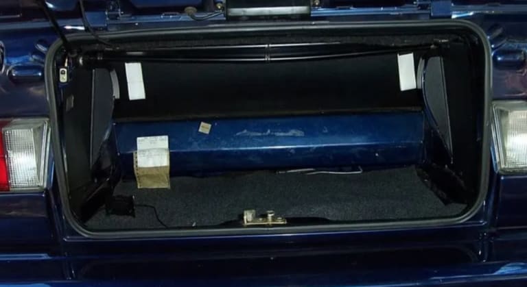

You can go out and research the vin, and I don't remember the free site, some one here will.  But I went out to the VWMuseum, and requested a Birth Certificate, and it had the mcodes for my vin.
The Mcodes that are on your white decal affixed to the rear strut cross bar in the boot should be accurate for your car.
mine were always affixed in this location. Screen Shot 2025-04-01 at 5.59.51 PM.png
