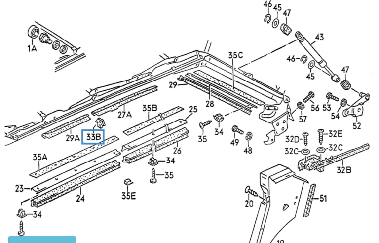

33b pn 155871419

I'll have a look tomorrow and see if I have the little end seal.

Well there are little itty-bitty seals between them and I always opened the top, and moved the seals to each other with the Palm of my hand.
When I replaced tops I use a good wipe of Vaseline or wd40 on the tray so that I can move the seals easily a wee bit left or right. I also use wd-40 on the seals them selves to clean them.
33b pn 155871419
What manual are those diagrams from please
