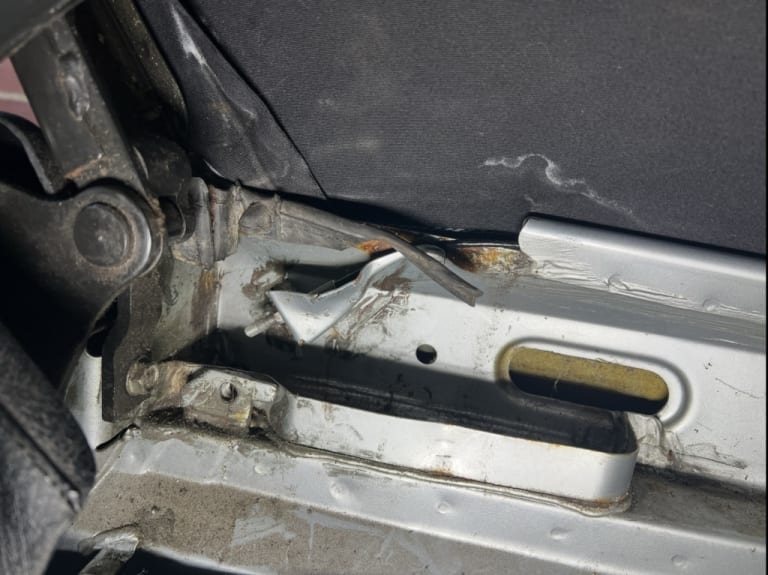

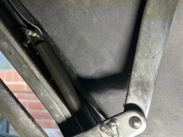

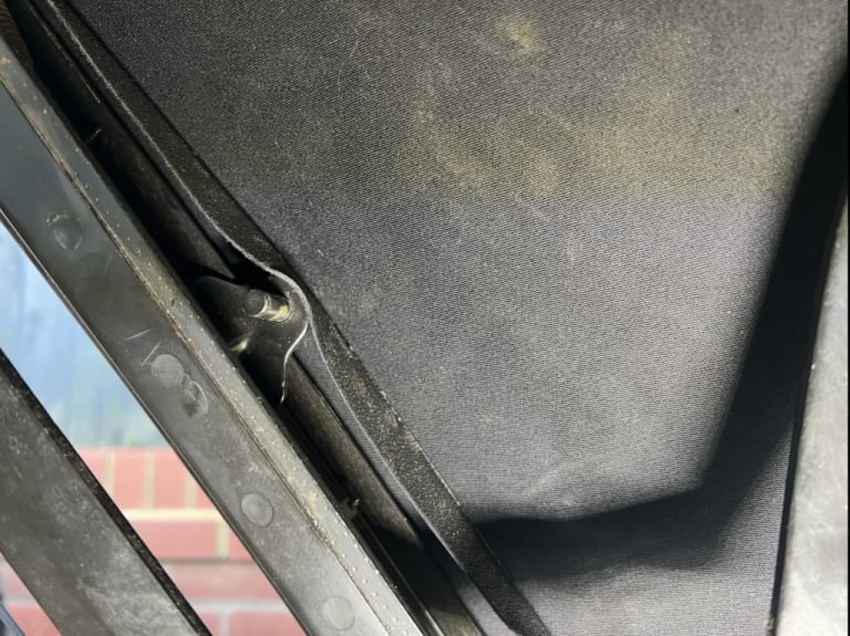

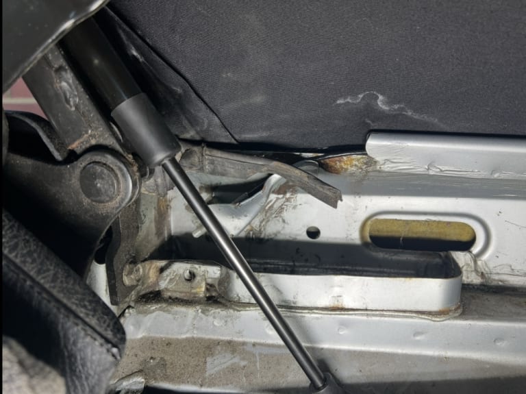

When taking a look today I seem to be missing the part in the attached photo.
The roof frame has the fixing for the other end of the strut, but there is no where for it to fix at the bottom.

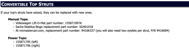

2025-04-29 16_36_03-Microsoft Word - Hood.doc and 16 more pages - Progeny - Microsoft Edge.png

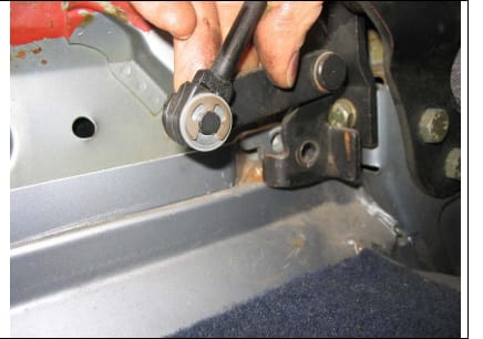

Below are photos of the car, and there the missing link as it were should be.  IMG_3594.jpeg IMG_3593.jpeg IMG_3592.jpeg IMG_3591.jpeg

It’s the bottom strut bracket that I seem to be missing. I’ve managed to do some more Google sleuthing and I have found the following part numbers from this thread:
155871838B right
155871837B left
Can’t find anywhere selling them online (unsurprisingly) so I’ll have to see if anyone that is break a cabby has some available.
