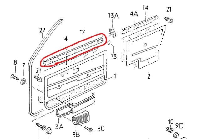

Sorry; the interior trim that is glued along the inside the full length of the top edge of the door body. Bottom edge of it goes behind top of door card, top edge of it goes behind inner window scraper. Holes in it for door lock pull and access screw.
Chris.
This one:
You can use double stick 3m weatherstrip tape which would probably work well because it is held in place at the top by the seal, and at the bottom by the door card.
