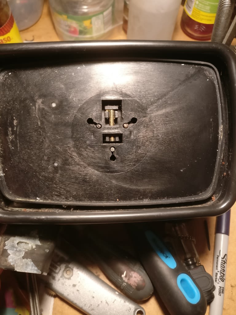

Thanks, but that looks like a newer type than mine (83). I've got glass off and I'm now looking at this.
Its definitely different to the later type.
The metal bit (that attaches it to the car) is really scabby but unless I can separate it I don't see how I can paint it as the mirror housing obscures a lot of it!

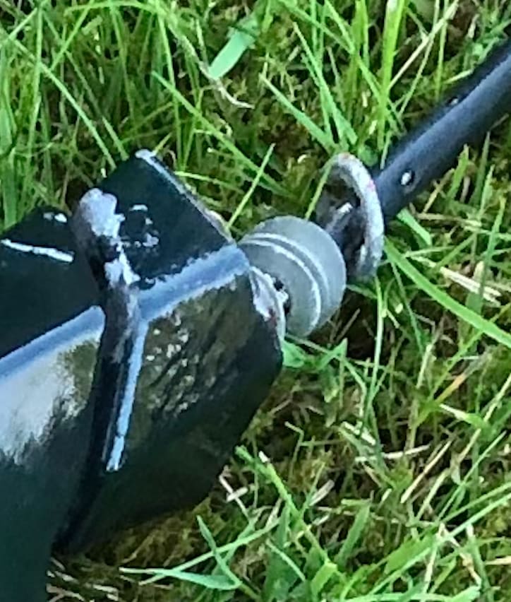

Here is my old one:
You can see the extra rings hanging off. The star ring is off, but the mirror is still attached to the base  :(

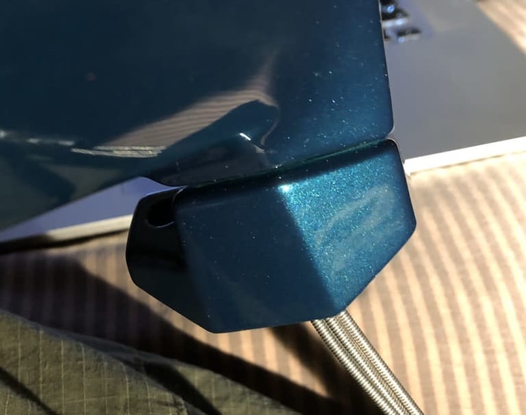

He said it didn't look like it would go back together, so he pained it as one piece. The one I gave him was in good condition so he only had to go back to the primer. Then he masked the mirror and fine line masked the black trim.
