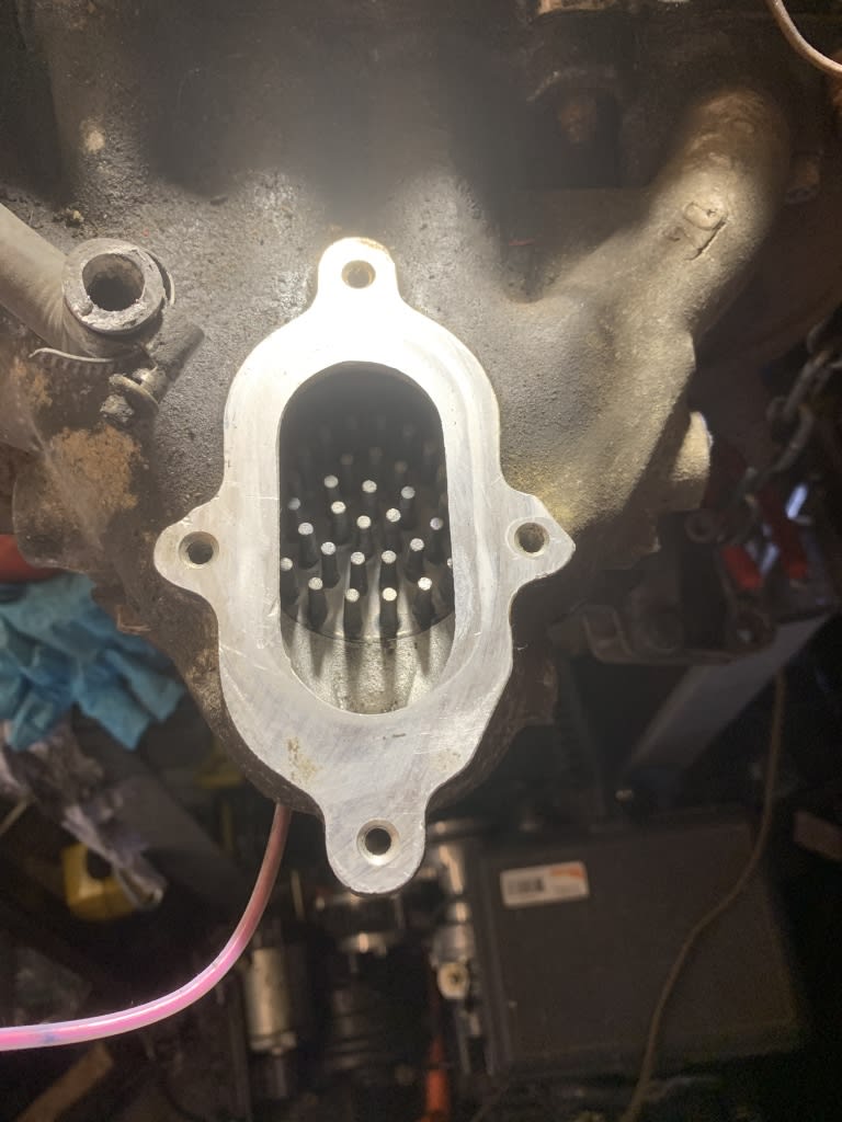

I have an aftermarket Webber DMTL carb for it but I have a question. The inlet manifold has a set of pins cast inside the inlet tract. What are these for? I'm guessing that they create turbulence in the combustion gasses but do they work or should I consider grinding them out?
'hedgehog', electrically heated element to stop 'icing' in the colder damp months (ie about 3/4 of the months in the UK). Find a 1.9D from a MK3 Golf and install that instead of a petrol.

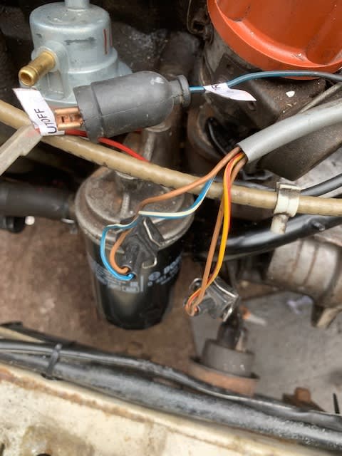

The part of the loom that runs don the middle if the engine bay is the original diesel and still has the pre heater wire which I assume I can remove. On the right hand side below the brake fluid reservoir there is a twin connector on both sides but the Clipper loom has neither of these, what are they for and do I need to wire them in? I do have a connector on the clipper loom that is quite close which has a yellow/white wire and a brown wire, what does that connect to?

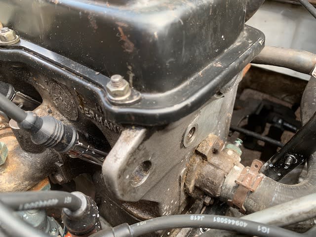

I am missing a sensor on the right of the head which I think is either oil tea or oil pressure and below that on the water pipe bit is another sensor which I'm guessing is water temp for the gauge. What colour wires should connect to these sensors?

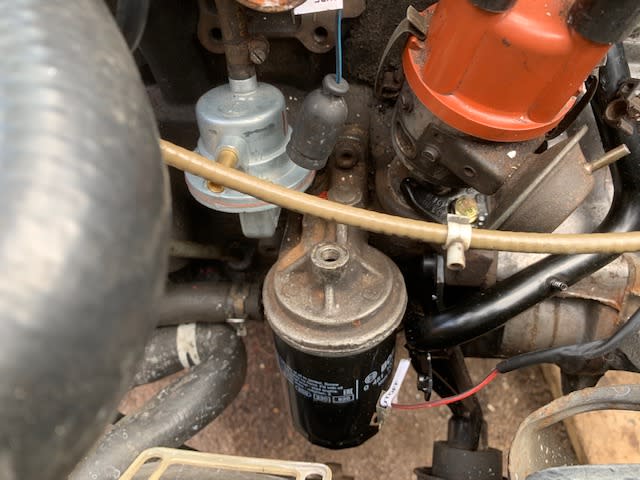

Moving round there is a hole for a sensor on top of the oil filter housing which I think should be the low oil pressure sensor with a blue/black wire that looks like its in the right place and the to the left of that there is a pair of sensors above and below the outlet that goes to the radiator. I have two connectors (wrong type for the sensors but I don't know what either of these do and which should connect to which

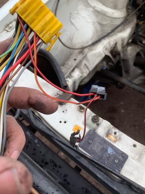

Moving inside to the fuse box there is a branch off the main loom connector with a red/black and red/yellow connector branching off which in turn has a single red/black wire and connector, what are these for and where do they plug in?
I don't think that you could use the Standard "CAN" dual ported Switch/Pressure sender as the ones fitted for the 1.8 isn't rated high enough for the pressure as the standard is 5 bar, and IIRC the running pressure in a Diesel is closer to 7 bar. I think that you would blow the can sender up. Not saying that they don't make a pressure sender for Diesels I just don't know of one off the top of my head.
The ones on the flange are black single pin for the Oil Temp, and the other for the Low pressure at High RPM, but then too I don't know the rating or the color of that sender.
The sender on the water outlet flange should be for coolant temp sensor and the CTS sender that should tell the ECU on a Cabbie what the engine is doing usually in the outlet flange in 85-89 cabbies it was a single pin black sender similar to the oil temp sender on the oil filter flange to move your gauge in the car. It should be the yellow/red with the brown wire connector for the water temp gauge in the clocks.
The Blue/black Capped one is the low pressure/Hi rpm sensor wire.

The side of the head is where the LOW Oil Pressure switch was located on my Diesel, it was notorious for leaking oil and I usually replaced it every 40K miles over the 20 years of Dieseling.

yellow/white and brown 2 pin is for front fog lights. the switches on the master cylinder are for the brake lights, dig the wiring out of the old headlight loom or it might be a separate loom that goes through the bulkhead on its own depending on age of car
oil switches you should have a 0.25 or 0.3 bar switch in the side of the head, blue or brown in colour. filter housing its 1.8 bar white.
sensors in the front flange are thermoswitches for autochoke heater (white) and inlet manifold heater (red) if you have a weber the white one isnt used.
on clipper loom the red/yellow and brown 2 pin plug is dash temp, cut the plug off and pull it over to the single spade sensor in the side of the head. the other 2 pin plug doesnt look right for a carb, what engine was it from? The inlet thermoswitch would be black and purple/black with a red plug, and carb heater would be yellow/black and black with a white plug…
yellow/red and red/black is fusebox plug for brake light switch wiring I mentioned earlier, so find the original wiring for it or make one if not its only 2 wires, simples

This part of the loom is from the original diesel ie the blue/white oil pressure sensor, the blue white and brown with the connector, the yellow red, brown with the connector and the red(file cut off?) I don't have black and purple/black wires, can I get away without a carb heater?

white/blue and brown will be for the diesel temp sensor for glowplug relay I guess.
you only need the carb heater for a 2e2 type carb, if its had a weber then no need to worry about that. The inlet heater is still there though, but you may find it makes no odds without. If you do need it check the blue/white from the sensor, if it goes to D/13 on the fusebox then you can use it for the red thermoswitch, pop a spade on it. then you put ignition live to the other pin, fit a inlet heater relay #1 to slot 2 and run the inlet heater to spade N (can re-use the glowplug wire)
