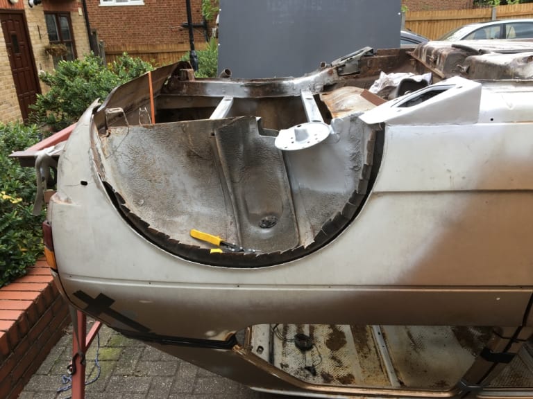

I've managed to get the Tt swing arms in and the springs but the shocks end up near the rear bumper bolt when keeping to Tt geometry.
Any help or pics would be great
Photos are one of rear swing arm mount and spring mount and haldex mounting rails in my mk1.
Other photo of jig showing were rear shock mount ends up black circle is were ide like to move it to.
