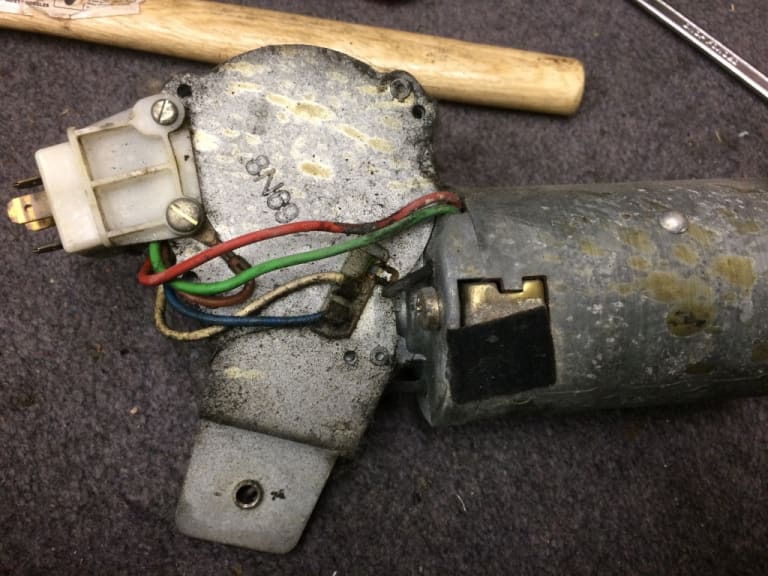

- 0V gnd
- Blue
- not used
- Red
- not used
MK1 wiper has 5 wires:
A) white/black - on the motor this is blue
B) brown - on the motor this is 0V gnd
C) green/yellow - on the motor this is red
D) green/black - on the motor this is white
E) green - on the motor this green
On the motor the green and red go inside the motor.
On the motor the blue and white go to a terminal on the motor.
I'm suspecting B->1, C->4 and E-> 2. Is this right?
What do I do with wires A and D on the old loom?
Please advise.
Central Electric 1
Gives you the colours for the original wires to the wiper motor and their function
Info on the mk3 motor install here
https://vwgolfmk1.org.uk/forum/index.php?page=topicview&id=helllllpppp%2F2-helps-please-mk3
and more info here
https://vwgolfmk1.org.uk/forum/index.php?page=topicview&id=electrics_2%2Fwindscreen-wiper-motor_2
Ian
MOTY 2013
either splice, crimp new 2.8mm latched spades on the mk1 wires, or crimp spades on the cut loom and push them to the mk1 wiper plug
