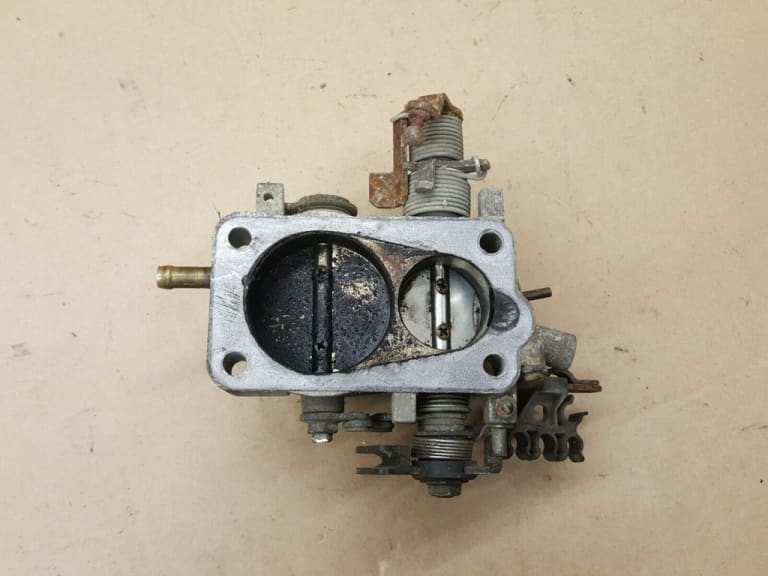

it's a question that's been asked a few times but I am struggling to find confirmation on parts or part numbers and the posts that have photos show the part numbers have expired (IE the photo does not exist on Photobucket anymore)
I am looking to change over the throttle body on my MK1 to a Audi 80 / MK2 with the larger butterfly's for better throttle response
I just need a bit of help checking what parts i need, Am I correct in thinking it would be the below two items? - if not could someone provide me with the part numbers?
This throttle body;
https://www.ebay.co.uk/itm/Butterfly-valve-B4-158-037061R-Audi-80-90-B4-100-2-0-Petrol/283180264648?ssPageName=STRK%3AMEBIDX%3AIT&_trksid=p2060353.m1438.l2649
This WUR with the vacuum hose attachment
https://www.ebay.co.uk/itm/VW-Golf-MK2-Warm-Up-Regulator-WUR-027133403/113988223328?hash=item1a8a3a4160:g:qBgAAOSwLfxd3DH4
Thanks in advance!
https://vwgolfmk1.org.uk/forum/index.php?page=topicview&id=big-block-injection_2%2Faudi-throttle-body-with
the key thing with the WUR is making sure that the diaphram is intact, if you can suck air through it, then it's bust and you'd need to get a rebuild kit (not cheap!), but then probably cheaper than buying a fully reconditioned one.

rubjonny said
Excellent Find! - THANKS A MILLION
now I just need to find a reasonably priced WUR
