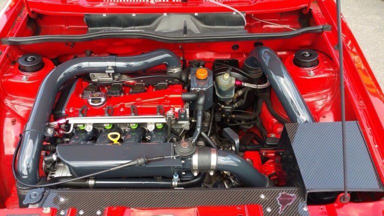

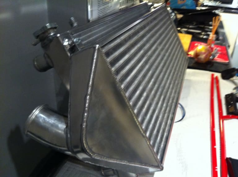

You will have to make some alteration as it pushes the radiator further towards the engine.
The cooler sits about one inch off the cross member and about an inch lower than the slam panel, and pretty much full width.
You will have parts that are blocked by metal work but nothing you can change about that unless you put the cooler on the outside 😳

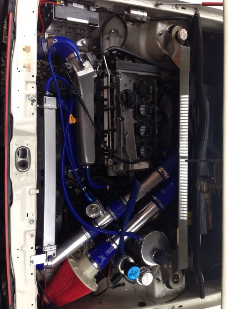

Intake temp is 72 degrees at 238bhp and 60 degrees at 232bhp photo don't show pipe now runs between bulkhead and expainshon bottle.
Last edit: by peeky
Everything else looks ok?
Does the turbo to intercooler pipe run similar way to how ive done mine?
