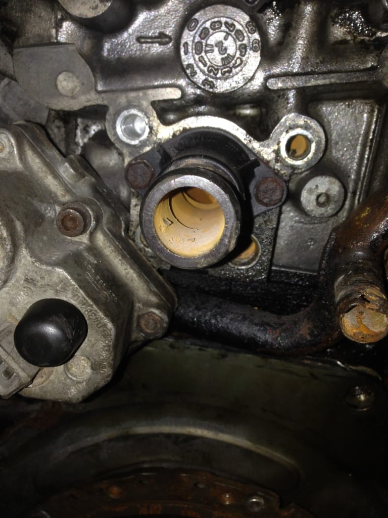

I'm after the water sensors and sendors for 1.816v KR engine under the dizzy 3/4 of them. I am running k jet it never came with my engine so don't know what I need
Any info would be good
are you running standard k jet?
I think 3 of them are the same type of water temp sensors but one is the thermo time switch for your 5th injector, the dx one should fit but not tried myself.
 you may not need one sensor if you are not using mk2 idle valve. I can get a pic of the wiring if you need it
 also the dash temp guage sensor is on the back of the head so check that its fitted
As above, 3 temp senders with black collars, 1 is for ecu, 1 is ISV and one is dash temp gauge, one on the back of the head is oil temp though
