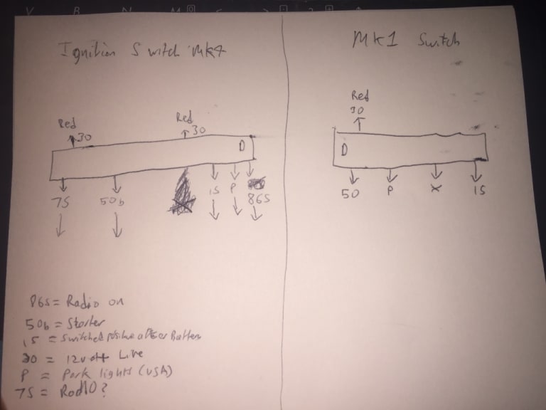

I'm in the middle of doing the wiring behind the mk1 jetta's
Dash, basically the mk4 loom is installed in the car, but it's keeping the orginal steering column and dash switches, one of the problems I've got is the 7 pin mk4 connector for the ignition switch which has terminal 15/30/75 etc
I want to remove the connector and heat shrink it onto the mk1 ignition connector so it plugs on to the original ignition switch
Can anyone help me on the wiring mod please?
Things to help are, it's a mk4 golf pd130 manual so there's no starter inhibitors and the reader coil is going to be located else where as a secret immobiliser 😉
I've managed to use rubjonnys technical information from his signature to sculpt this but terminal 75 and 86S (radio) I'm a tad unsure which wire they should connect to? Hopefully this helps …… helping me lol
Both terminal 30's got to the mk1 terminal 30
Terminal 15 goes to 15
P goes to P
Terminal 50b for the starter goes to 50

86S -> S

I figured I'd say I've installed the complete mk4 loom into the car… silly I know but it's fitted and works, means all electronics are ecu or relay controlled etc
