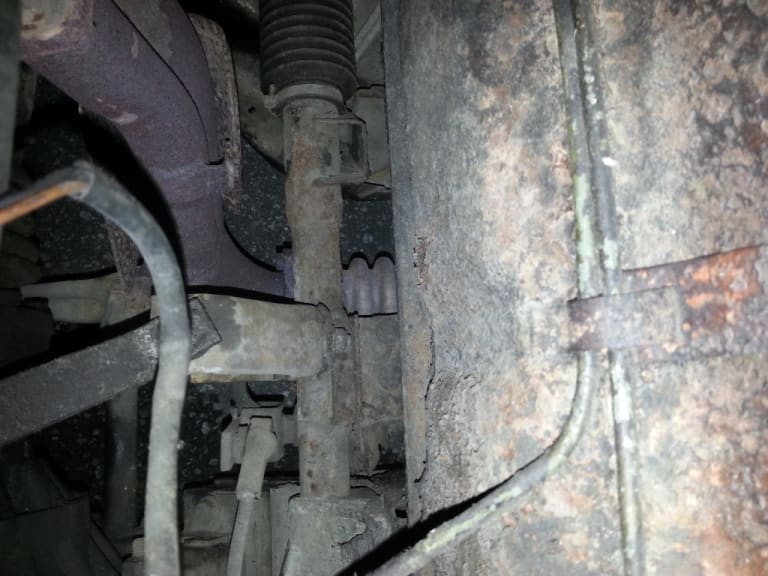

yes I do have the 6-bolt manifold, but the non-gti version, which has a smaller mounting surface and will not fit the gti-downpipe with the ARB-bend. I know it's smaller because I had it off this winter, and the 6-bolt gti seal I bought was to big to fit.
Anyway then I'll settle with the 4-2-1. I'm gonna have to do the rest of the exhaust as well, since the corrugated pipe won't match the new 4-2-1. Also the previous owner replaced the exhaust sometime in the 80's if he recalled so it's about time :p

Current downpipe. Pardon the disgustingly filthy engine bay.
