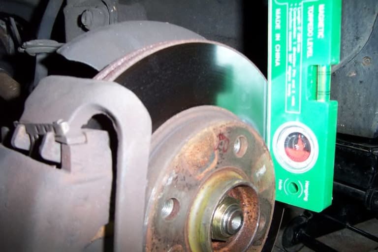

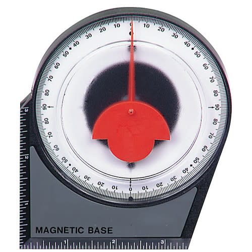

Got the bigger one because my Eyes aren't as good as they used to be. Also make sure that you get your strut tube in the same relative position in the spindle that the old one was prior to setting the Camber…. There is a lot of difference between camber in the Air or on the ground buy as much as 5 degrees. Once it is on the ground, you can reset it to the value you have before you jack it up.
