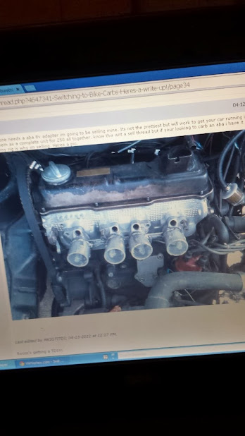

after having a read its to my understanding that these heads produce more power than that of a standard head that has been ported and polished but im not sure of the figures , the setup is perfect for bike carbs and getting the induction away from the heat produced by the exhaust manifold and also turbo conversions so i thought this thread might help a few people aswell as myself , i want to know what you have done and the setups you run . here are a few i have seen so far

Ordered a head been removed from a low milage 1.6 audi a3 and i have stripped and rebuilt the carbs with drillled jets to 160 . Ill upload some pictures when the head arrives
