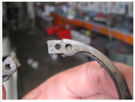

it is probably the wrong clip.
The proper clip is in the rear, the large bad eared clip is in the front.
A lot of kits on the interweb have the wrong clip, just re-use your old ones.

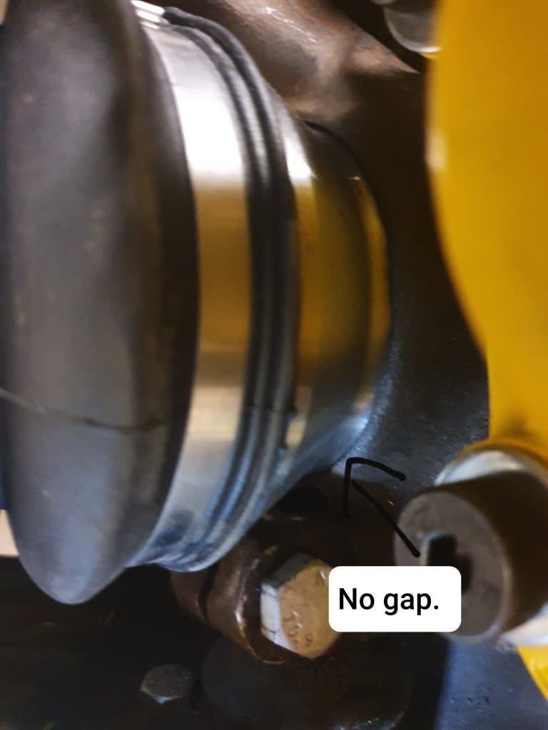

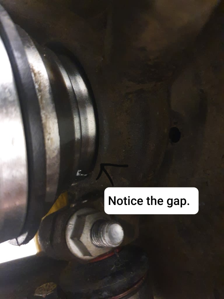

Just took a quick glance at the car now that I got off from work and it seems that on the drivers side the outer CV might be the one holding against.
Passenger side, which is just fine :
Drivers side, which gets stuck :

It was indeed outer cv hitting knuckle and I also made sure I had correct circlips there.
I just sended it with dremel and carbide bit and grinded down knuckes after all : I decided not to grind cv:s, becouse I would need to do it everytime again if they need replacing at some point and also if there was even a slightest chance imbalance would give me any trouble.
